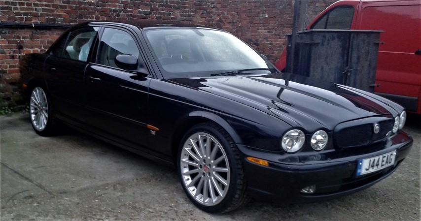

I`ve owned my 350R for nearly two years now. How I wish I`d made the break from my old S-type years earlier. At the bottom of this post you will see what I`ve done to mine.....and thats just part of it. I`d suggest you trawl through the various sections on this Model Forum and get a feel for how these cars operate on an everyday basis. I`ve posted many threads about this model in predominently engine, transmission and suspension sections. If you study those, you will become a very strong buyer and be able to know what to look for when you seriously go on the hunt.
