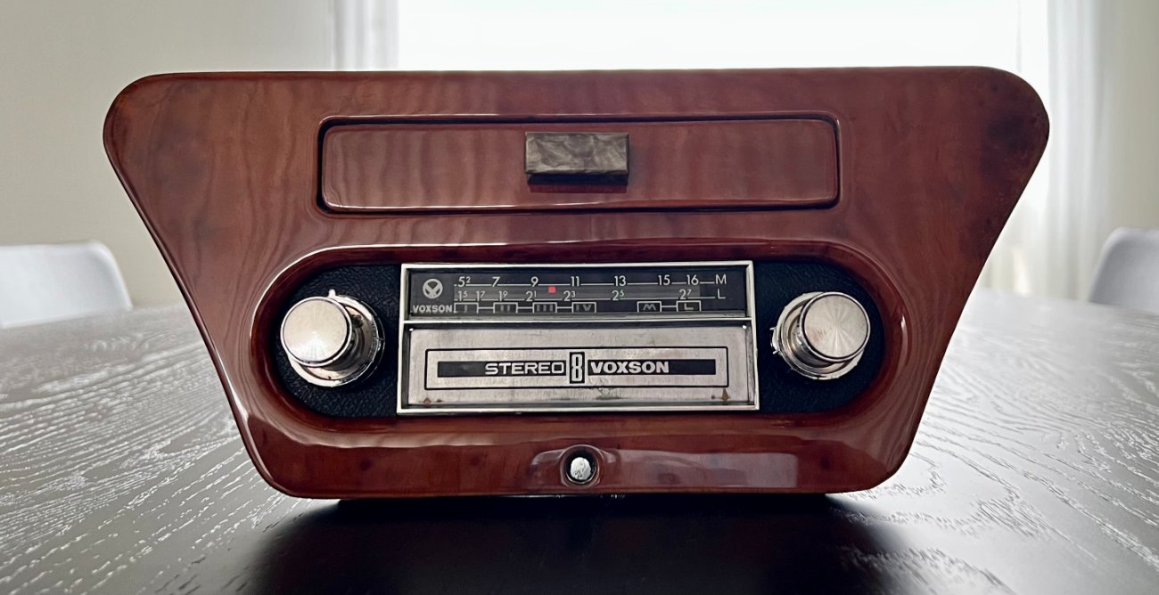

Re: What replacement can I get for my 420G Radio?
Hi David, I have replaced my original 8-track (radios were dealer fit, so anything of the period is correct) with a single DIN Pioneer that has a fold-out screen (Pioneer AVH-7250BT). This means I have apple car play (incl. navigation), hands-free and a reversing camera. I am very happy with the set up, fits nicely, the screen does not interfere with anything including the heater controls (of course you have to fold the screen down to use them). Also means my wife can drive the car as she demands a reversing camera. To achieve this I purchased a second timber piece, so I can easily disconnect the modern radio and replace it with the original one (ashtray and all) for concours (of course reversing camera removed from the rear as well). For the single DIN to fit you have cut the opening in the timber piece to fit the square shape. Unfortunately, my car is at the mechanics so I cant take a photo of the screen out.
https://caraudiocentre.co.uk/products/m ... h-z7200dab
Steve
Steve
Steve,
Lovely dashboard! Looks great!
