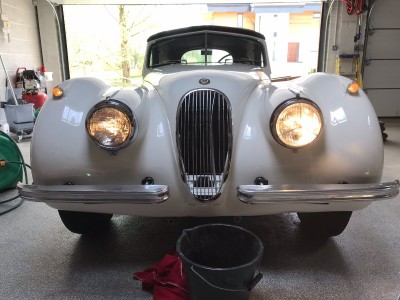

So for anyone wondering just how much better the new lights/halogen bulbs are...... your wait is over:
One on the left is the original US sealed beam unit, the one of the right is a P700 (this is a LH drive vehicle so they shipped with smaller 7” lights - that have a significant cost advantage over the UK PF700 units), with a halogen bulb.
On taking the lights out and investigating the wiring (which was already converted to Neg earth), the loom is brand new so there was no need to alter the loom with relays etc..

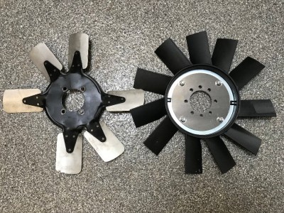

Swapping the engine fan out. I bought an upgraded part from Guy Broad:
Trouble is on trial fitment (with the rad still in place just the top hose and clamps removed, the blades foul the underside of the (new, upgraded alloy) radiator.
So question is do I persist with the new fan (painstakingly removing 2-3 mm off each blade) OR stick the original fan back on? Anyone of here used the new upgraded part - is it worth the hassle? I have to think that 'fan science' has moved on a deal in the last 60+ years so wouldn't be at all surprised by the upgraded unit shifting a ton more air than the old unit........ but does the benefit out way the time and hassle to fit it?
Nabbott
Posts:6
Joined:Fri Mar 30, 2018 3:32 pm
Re: Sensible mods for a 120?
Postby Nabbott » Thu Apr 26, 2018 12:19 pm
All fixed - but for anyone attempting this job it's a radiator out job (that bottom hose is a total PITA!). I had to dremmel the leading edges of each blade to provided tolerance on the bottom of the radiator header.
