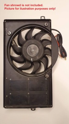

Postby V12Smig » Wed Dec 09, 2020 1:14 pm
Hi Guys I have found one...

Postby mike020150 » Wed Dec 09, 2020 3:27 pm
The auxiliary fan only runs when either the aircon compressor is in operation or the radiator is suffering heat soak after a run in warm weather. That doesn't work the fan especially hard in the UK. A similar mod which might have more benefit would be to replace the viscous fan with a well designed electric one with matching cowling to give more controlled cooling and improved access at the front of the engine. I recall there was a very nice looking kit available in the USA from a V12 specialist there - just a thought. Mike.

Postby V12Smig » Fri Dec 11, 2020 10:25 am
Yes Mike, I should've done that before I spent cash on a new viscous and fan assembly and refurb'd the shroud..… but I've done that now. Considering how hot its getting here and the fact that I will be taking the car to France and Italy during the summer months the auxiliary fan will be doing a lot of work...
