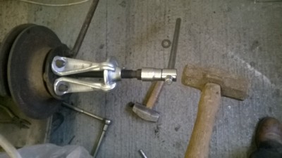

I got my 3 leg puller off e-bay , think it was around £20 inc post , did the centre bolt up very tight and hit it with a sledge hammer , just popped off , car is a MK2 !

Ah,
We are at cross purposes here, Yes the MK 2 has a half shaft with a tapered end onto which the hub fits. I have used three leg pullers with a hydraulic ram. They work a treat, in that enormous hydraulic pressure is applied. The secret is to clear off for a cup of tea and wait. Usually, half way through ya cup of tea there is a tremendous bang as the taper lets go and all the bits clatter to the ground. A load of rags beneath helps.
