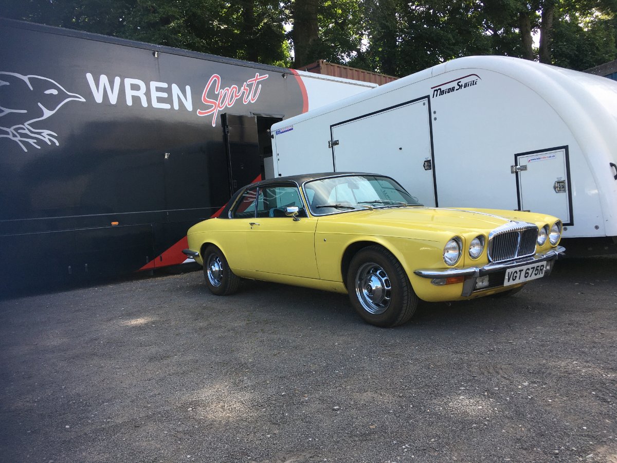

series 2, 1977 4.2 coupe. engine cuts out whilst travelling, switched over to right tank and off we go again, my Garage mentioned the left pump was failing! but I tried it on local short runs and it was fine, the last time this happened we did approx 25 miles before it stopped pumping, I wonder if it is the pump (submersed) or could it be the left/right switch ? before I place an order for a pump with Barretts.
