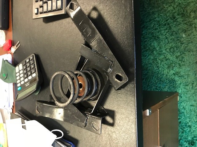

Its four bolts under the car to remove the gearbox mount, be sure to use a transmission jack to take up the weight and support it when you do the repair.
parts to change are the central spring and the bush, here a photo of mine

Thank you for the information and the photo.

The bush is probably CAC3227. Not sure about the spring as I think they might differ between 4.2 and 5.3. I just changed the bush (on my manual car) and did it with the car on ramps using an axle stand to support the box and a trolley jack to take the strain while I undid the bolts. I also needed the trolley jack to compress the spring enough to get the bolts back in. Easy job if you don't mind getting under the car.
