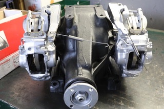

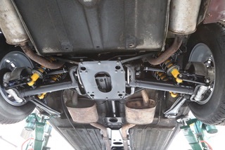

Some photos of my car to get the jest of the refurb.
- Attachments
- 312A4421.jpeg (33.67KiB)Viewed 2222 times
- 312A4369.jpeg (32.99KiB)Viewed 2222 times
- 312A4125.jpeg (33.32KiB)Viewed 2222 times
