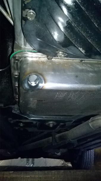

There's an uprated neoprene sump gasket - 107281/U - £12 from SNGB - I used one on mine.
When the sump is off, have your local engineering shop braze on a drain plug - makes later fluid changes so much easier.

Is there an off-the-shelf drain plug and socket around that I can post to the workshop before my next visit?
Do the ATF sump bolts have a special head requiring a specific tool to remove?
Automatic Choice didn't have either available

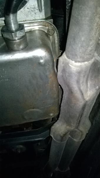

Postby Tintin » Sat Jul 15, 2017 9:56 am
HI Richard
The bolts are 1/2 AF spanner size - those on the LHS are tricky to get at but I managed it without moving the exhaust - very fiddly and tight access. The tightening torque is 13 ft lbs or 18 n/m. You won't get a torque wrench on all bolt heads with the exhaust in place but it should be OK tightening by "feel". I had to grind down an off-set ring spanner to get a purchase on the last bolt head.
Your workshop should have access to a source of plug kits (can't remember who supplied mine) but insist on a Dowty washer and magnetic tip for the plug.
