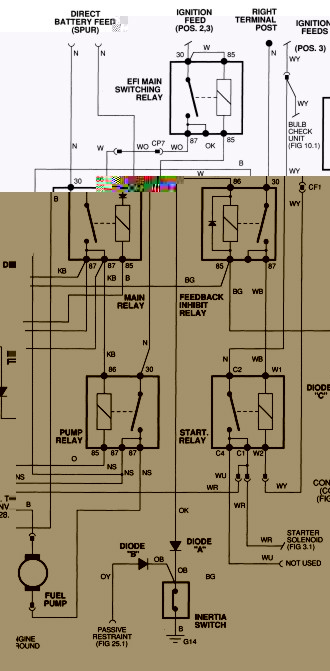

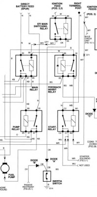

I think you are going to need a better manual than Haynes if you want to pursue this. The wiring diagrams on the JDHT supplement CD might help. Not sure if this will be allowed but a relevant segment from one of these included below.

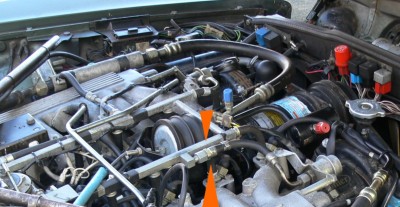

Where would i find a fuel pressure gauge, & how would I fit that please ?
Google fuel pressure gauge. You need one that reads to 100 psi (a good fuel pump can manage that) but the range you are actually going to see is 25 - 40 psi.
It can be plumbed in anywhere on the fuel rail, via a T piece. One option indicated below.
Al McL
