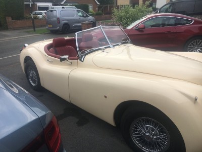

I have a 1983 series III EFI engine fitted in an Autotune Aristocat (a kit car with almost all the donor XJ6 mechanicals fitted onto a spaceframe chassis and an xk120 like body).
Has anybody fitted a more modern EFI system? I am basically looking for more power, so any other solutions on that front are of interest.
