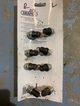

The old spark plugs (they’d been on my workbench for a couple of months when this was taken)
