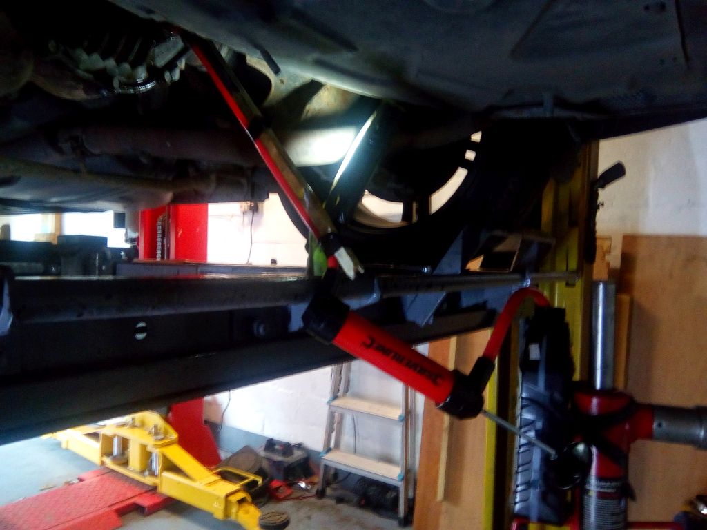

The first task is to get the filler plug out. This is a square 3/8" with very little space. I was able to get a ratchet driver in place with no attachment. You should be able to see that here.

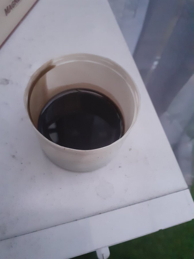

The old oil came out smelling badly, so I'm sure it was time for a change. I'm happy to say there were signs that this wasn't the first time it had been done, so in line with other things on this car, there is plenty of evidence to suggest that East Riding council looked after the car very well in its 10 or so years with them.

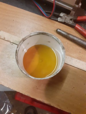

A very necessary job on all modern Jaguars. I recall Jaguar schedule this service work every 90K miles. My own car was treated to a diff oil change at eleven years of age and some 80K miles covered. Here is what Tom Lenthall removed from my car. As you found, rather smelly and nasty and definately with little lubrication quality still remaining. Seeing the appaling quality of my oil at such a low mileage leads me to suggest that it could and probably should be changed at much lower mileage intervals. If I keep this car for a long period of time, which is something that is likely, then I shall be replacing that oil after another 40k miles of use. The cost of the oil is peanuts when compared with the cost of having to have a diff rebuilt. A new Jaguar supplied diff is known to have cost one of our members £2800 recently. Obviously regular replacement of oil will help towards avoidance of that outlay. A stitch in time can save nine.

Oil service maintenance is vital for a modern Jaguar regardless of what model you own. This is applicable also to supercharger and gearbox oil and filters. Ideally, those two oils should be changed at each and every service interval. Personally, I disagree that diff oil can be left until a 90K service aniversary. 40K or 50K intervals appear a better idea. That diff oil is subject to extreems of heat and pressure not to mention oxidisation. Nothing lasts for ever and that includes all oils used in our cars. Filled or sealed for life recommendations should be ignored. That is just not possible.

Just done mine - because I had to remove the rh driveshaft to try and replace a broken reluctor ring - it had snapped because of rust building up behind it. Needless to say, the hub would not come off the splined end and it was too big (diameter of cv joint) to put in my press. I ended up cleaning all the rusted area up and tack-welding the reluctor ring back together - it seems to be working so far!!
The colour of the old oil was a bit dire - well it has done 136,000 miles!
