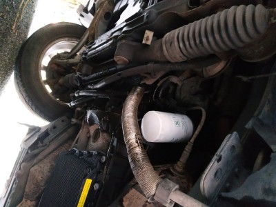

Phil, its dead EASY, car in the air, jacked, chocked and axle stands PLEASE!!
remove the engine under tray if it is still there,
locate the sump plug, check it will undo, then locate oil filter on a 3.0 SO easy to find and take off, but just check it will come loose first, remove sump plug, drain old oil, remove old filter
remove engine oil filler cap
fit new sump plug, fit new filter with a smear of grease on the seal, these only need to be hand tight, fill with correct amount of correct oil, replace engine under tray, start car and test run , lower car, dispose of old oil and filter and away you go and enjoy the car again

One quick clarification though, do I remove the sump plug first or the oil filter, probably sounds like a daft question but i really want to avoid dropping oil anywhere but the tray I bought to catch it.

Ok, check the sump plug will come loose first, leave it in situ though, you do not want to drain the oil until you know you can change the filter, same applies with the filter, ensure it will come off before removal, other wise you will have new oil running round an old filter
then remove the plug, drain, remove filter, fit new filter and plug and refill
you must change the sump plug when doing this job

My aircraft training in regard to spin on filters was to oil the seal, turn on until the seal touched the housing then tighten the filter on further by 180 degrees. That is the method I use which has proved leak free and only needs moderate turning effort with a filter wrench to remove.
These filter seals seem to expand slightly in service which ensures a good seal and resistance to spin off.
