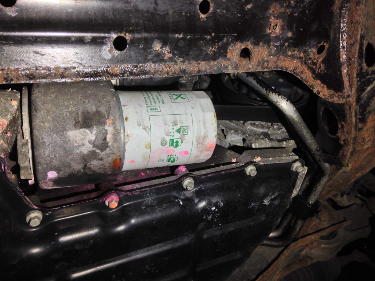

Has anyone else encountered these rivet like studs holding their undertray on? Went to do the oil change earlier and came unstuck at the first hurdle!

If I remember rightly, there are 3 bolts securing the front of the tray to the bumper undertray. In your photo I believe you have already removed these.
Working backwards, there are 2 bolts (1 in each of the holes in your photo). The rivets shown must not be removed, as these attach to a metal mounting bracket that the '2 bolts' pass through.
Working backwards again there are another 2 bolts.
Finally (on the rear edge of the tray) there should be another 6 bolts - 2 each at the outer edges and 2 at the rear (centre).
Good luck removing them without any snapping or just rotating.

Fantastic help, thanks very much!If I remember rightly, there are 3 bolts securing the front of the tray to the bumper undertray. In your photo I believe you have already removed these.
I only had real difficulty with a philips-head screw which had rusted in place! No amount of WD40 was going to shift it so I carefully chiselled around it and the undertray came down!

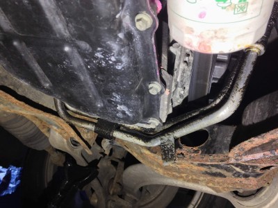

There was some coolant drips greeting me upon its removal; this would explain me having to top it up every few weeks (from just below Max to Max). I'm always paranoid that it'll suddenly lose it's coolant so I always carry around a 5L tank of coolant and 5L deionised water, just to be safe!
I attempted to 'tidy' up the mess as best I could. The gearbox oil cooler pipes were covered in an oily grease, hopefully that's not anything to worry about.
After peering up through the engine, I could see no sign of any coolant leaking at all, however I might invest in some radweld or similar to put my mind at ease!
