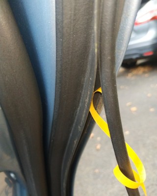

I tried the masking tape suggestion around the newer car rear door jambs, went for a drive and there was perceived lower wind noise. No decibel instrument science here. I then performed the strip of A4 paper grip test in various positions around the door jambs closing the doors and found tight grip on the paper all around the door jambs except for the rear lower quarter below the window to the bottom of the door. I then tried the test on the older car and there was a tight grip on the paper all around the rear doors. I therefore think I've found the source of the wind noise on the newer car? The fix would probably be some extra 3M "D" shape door seal around that quarter of the existing door seal, but I need to think a bit more on this first. I'll let you know more on a fix soon. Cheers Richard

Re: Rear road / wind noise 2003 vs 2004 V6
Solved !!!
Bought the 8mm x 6mm D profile self adhesive rubber sealing strip, thoroughly cleaned between the outer rubber folds and applied the strip to the inner flap of rubber folds of the lower rear of the door. 2 minutes each side and it doesn't look like an added rubber strip. The A4 paper strip is now gripped tightly by the shut door all round, the door is no harder to shut and following a test drive, the newer car is now a quiet as the older car. Might run the A4 paper test on the other family cars to check.
