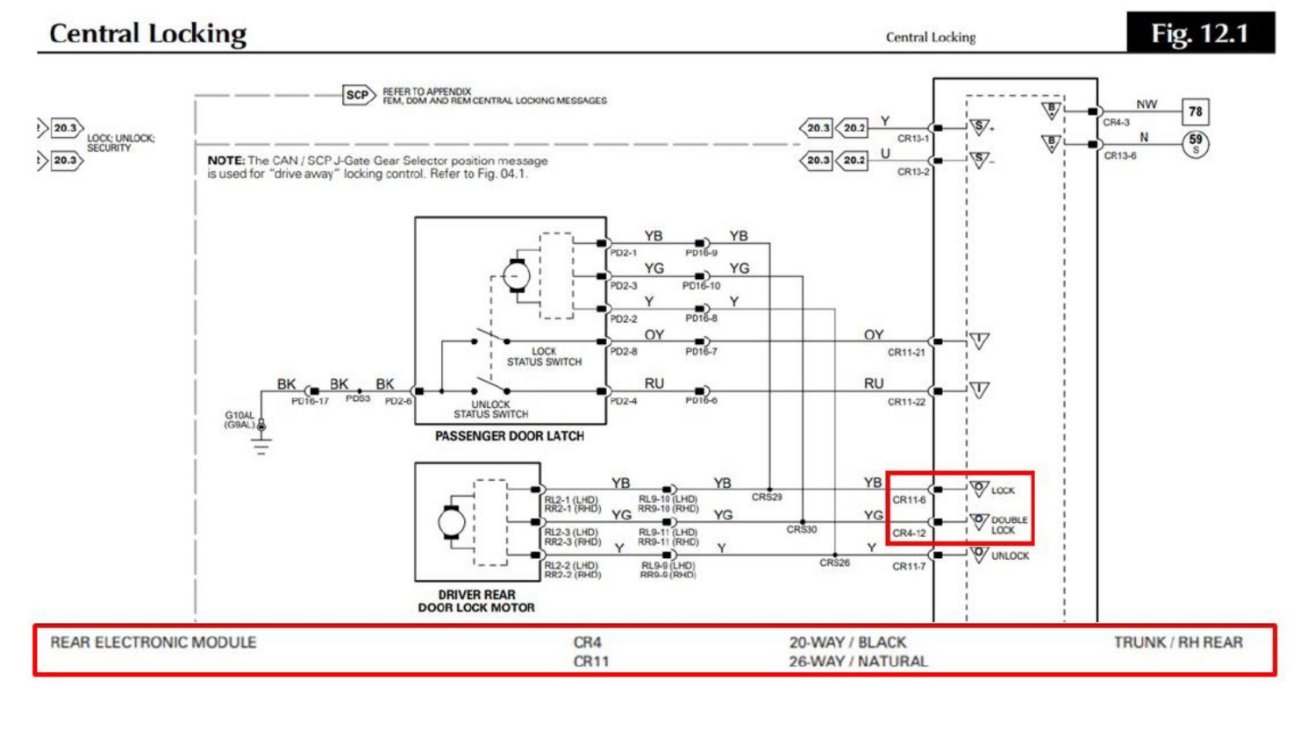

Found it.
It will be interetsing to see if this works for you.

Thanks IRS, I will certainly give that a try. I normally double-lock the car so that would explain why the handles inside are not working.
