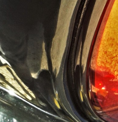

Parking rash sustained to the nearside rear quarter panel with a small depressed dink evident. Quoted £400 to fix locally...no way! As usual, I`ll do it myself.
The depression was impossible to access from the rear of the car. As metal gets dented, the surrounding material rises. A block of hardwood and a lump hammer managed to lower the raised area to near original levels. Good but not perfect. Images of work in progress below.

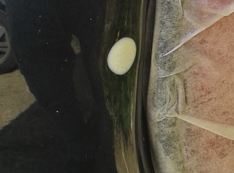

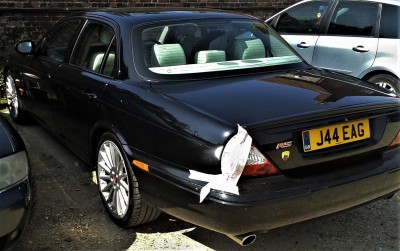

A dob of body filler upon abraded paint was next. Faired as well as I could get it into the panel profile, all abrasion scratches were removed with P600, then P1200 wet & dry paper. A G3 buff followed, then a wash and panel wipe with spirit. Three coats of primer, then more 1200 flatting. Over-spray removed and another buffing session. Another water wash, spirit wipe and the spray colour coat. That was lightly flatted to remove dust edges and smooth out the spray orange peel. Buffed again, washed and polished, the job was done.
A 95% good repair which certainly looks a lot better than the dent. Cost were a can of Halfords/Holts paint, some primer, filler, production paper and some G3. Total cost is about £25 with loads of paint and materials left in stock to deal with the next shopping trolley attack.
Panel repair work doesn`t need to be expensive or difficult.
