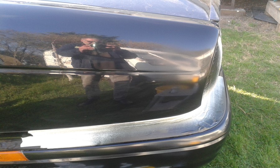

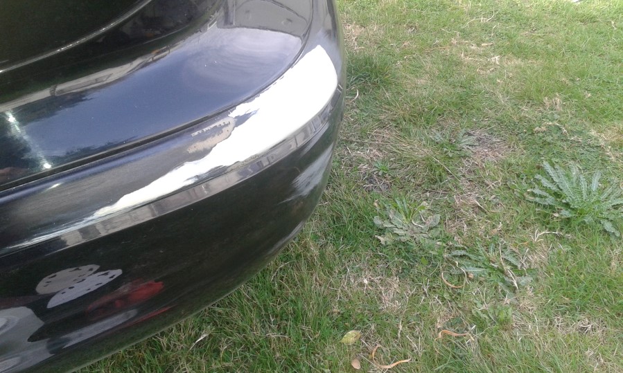

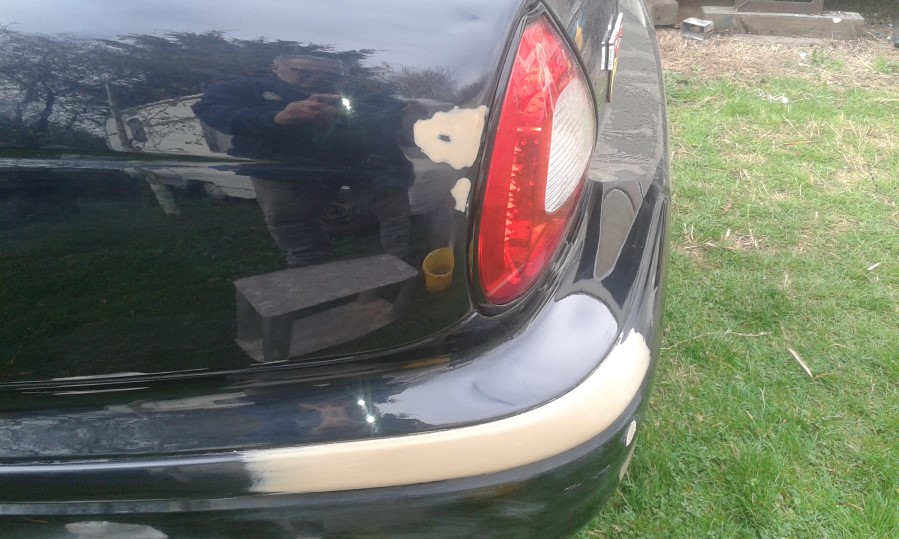

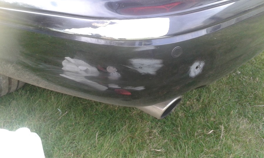

This car appears to be a magnet for parking rash attacks. The week before last, almost everytime I went out to get domestic supplies, I`d come back to find the car hit again. Beware living near Caterham or Warlingham in Surrey! On one occasion I returned to find a number plate screw sticking horizontally out of the bumper! Long nosed pliers had to be used to pull the head of the screw out which left a hole in the bumper cover. I had to block that up and ensure the hole disappeared. That has gone well.

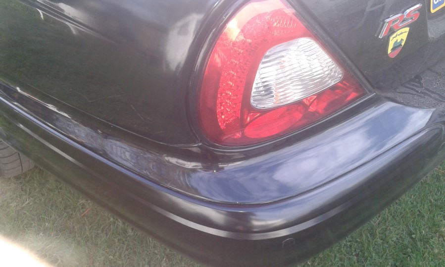

Paint on the boomerang trims had been pulled off, abrasion scuffs were along the bumper sides and worst of all, some ding damage had been done to the ali body. Fortunately, the light cluster was undamaged. Here is my repair sequence using Upoxy Super-Etch primer sprayed on with a small detail spray gun, further prep done, followed by top coat repairs using the Halfords special mix Holts rattle can paint. The results have come out well especially as I have had to fight off flu for the past week. The repair done in half hour stints.
I`ve repaired all the damage which has blended into the existing paint and finish. The final shots here were taken before I buffed up with G3. The finish is now a high gloss lustra. Repairs are vertually invisable but I expect to have to give them another rub up with G3 as the paint settles over the next couple of weeks.

Very tidy repair there Mike,very neat,wish I was as good with touching up body work like that,I think I will try Halfords to match my paint,used an online auto touch-up paint store but when I tried on a sample piece it was more blue than green,I put that down to having what I think is an unusual colour being Emerald Green with Blue Pearl Underlay but still never mind I'll get there one day.

Great repair Mike.

Thanks, Andy.
P2000 wet and dry paper together with a good clean up at each stage with panel wipe, works wonders.
