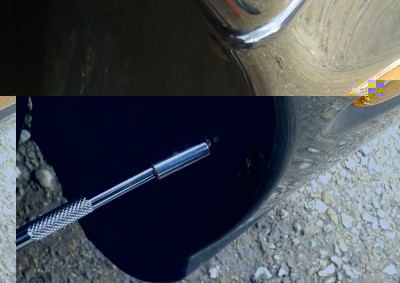

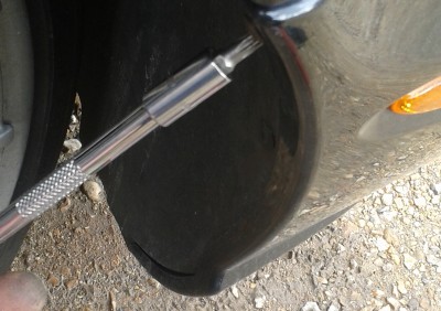

So with the rear edge of the bumper cover free, today I moved onto examining the fastenings that secure the front wheel arch liner to the rear of the bumper cover. A PZ2 type Phillips screw is present at the top rear edge of the cover. A lower Torx dome head machine screw secures the arch liner to the bumper cover. Steel to plastic in both cases so the fixings screwed out without issue. The location of these fixings are shown here.
Here is the PZ2 fastening on the upper bumper cover.
Here is the Torx fastening securing the arch liner to the bumper cover.
