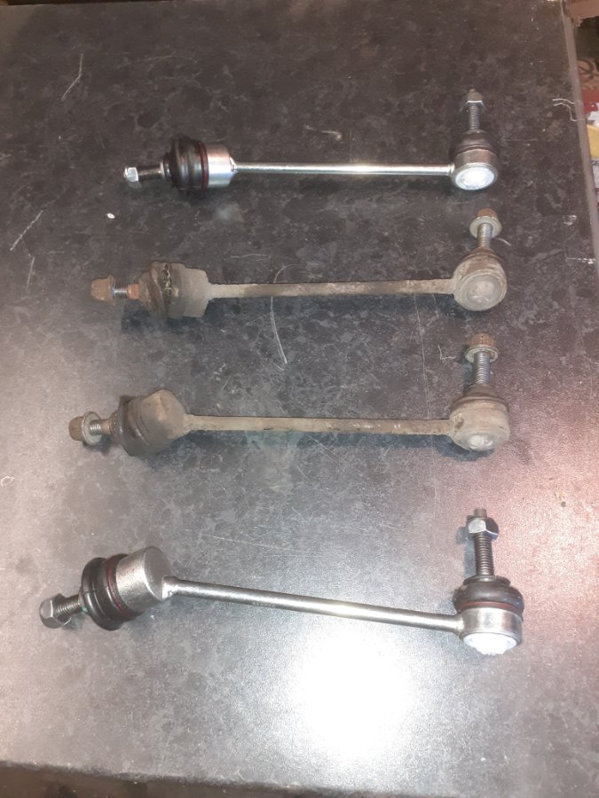

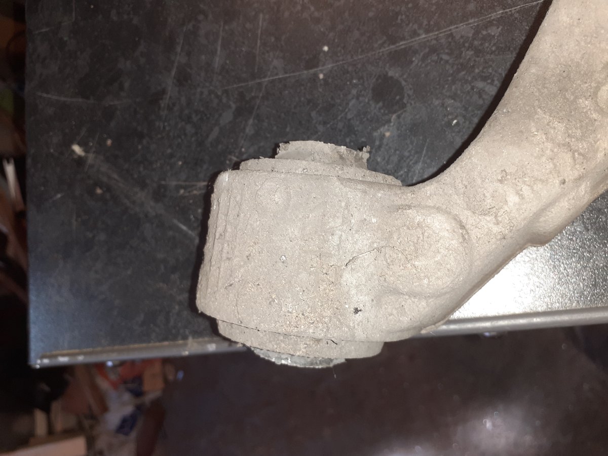

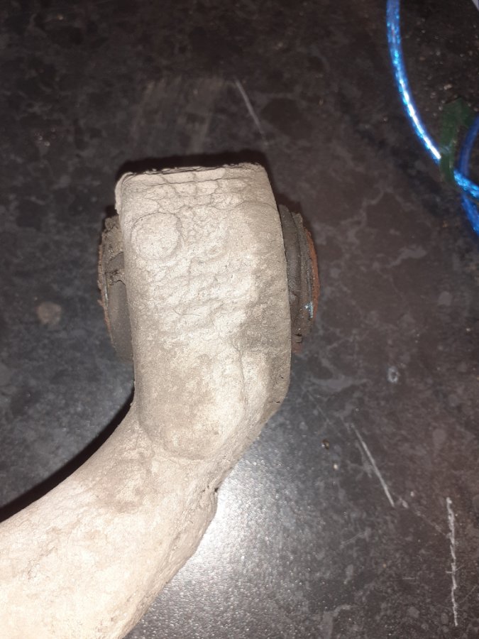

Had the same issue with mine.
Just spent the last 3 days doing my lower wishbones, stabiliser links and anti-roll bar links.
I used Polybush replacements.
