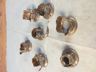

prior to lifting i wanted to undo the wheel nuts. no chance as the tyre fitter who fitted the new tyres two weeks ago damaged most of my wheel nuts using a air gun I had to use a Dremel metal cutting disc and chisel the outer casing off it took hours before I could start.

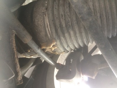

so with rear passenger side wheel off I was totally puzzled looking at the air suspension damper with what looks like expanding foam rubber and cable ties. the thing is the car drives ok (confused).
next with the front passenger wheel off and the car lifted having a look around revealed more insulation tape and cable ties around what I think is a suspension sensor. any ideas of how dangerous if any and a possible course of action would be appreciated.

Wheel nuts...squashed, typical after a few years with low grade maintenance. Replace nuts as required. Most of us have had to do it. Cheap enough on eBay.
I have one front sensor tied onto the drop arm due to it being knocked off by a tow truck ride. The spring clips corrode, split or get damaged. The clips are not available as a separate part but come as part of a complete new sensor kit. Can`t remember the price but probably not cheap......a couple of cable ties will do for a substitute and cost only pennies. My NSF sensor has been tied on by cable ties for about four years now. Does the job perfectly and can`t corrode. No comments made by the MOT man. A cost effective repair for peanuts.
One of your shots looks like a rear hand brake cable. The blob of sealant/glue may have been applied to keep the cable from contacting another part of the car. Hard to comment further on that.
