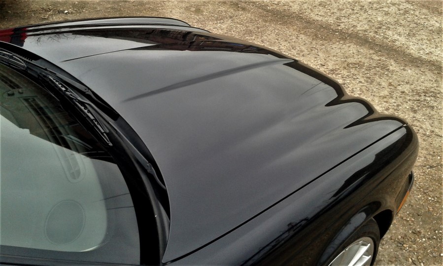

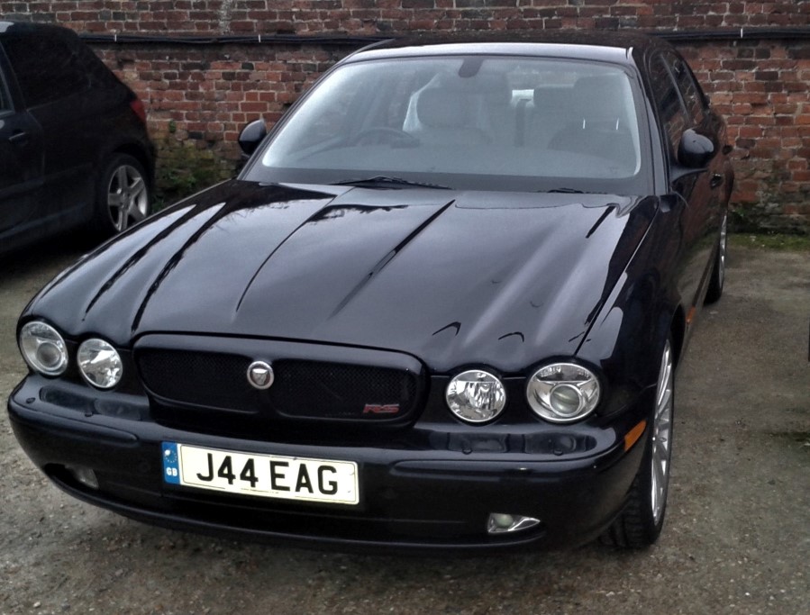

Here is mine after a mega clean up! It nearly killed me!
Thank goodness for clay bar, G3, water-less cleaner and easy wax!!

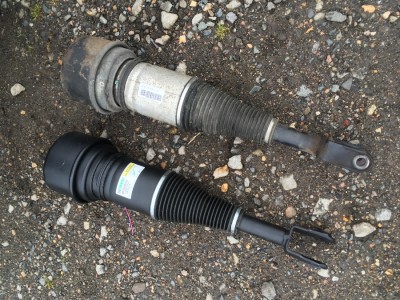

<t>Hi All, General update on things, have now invested in a replacement front air shock from Air Dominance and will attempt the change over this weekend. The unit arrived the day after I placed the order, thanks Mike for the info, cost was about £400.00 with £100 refundable on the return of my old unit for re-generation, they collect. As you may of read from my earlier post, I hit a unmarked traffic island in the middle of the old kent road which terminated the 20" Castello wheel (Guy Salmon replacement, £600.) and suspected leaking seal on the suspension unit was the only other damage after their inspection. A further disappointment is that I will be putting this car up for sale shortly, after I have sorted a few minor issues e.g. drivers wing mirror not folding back etc. Can be viewed at https://www.flickr.com/photos/139439575 ... 5833245693. 44k miles, £18000, will advertise car on Jec website in due course.

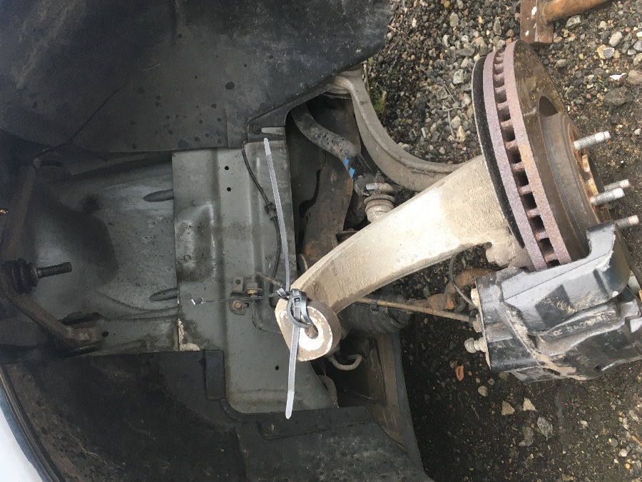

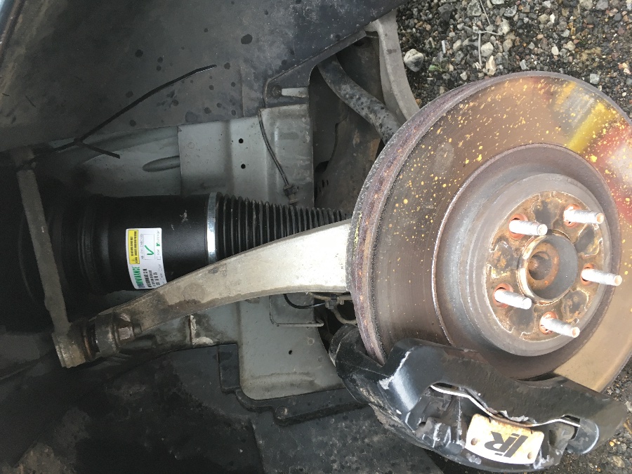

Hi All, Just finished replacing o/s front air strut with surprising ease. Mike's advice was invaluable, along with Arnott's you tube video showing the process. The only trouble I had was the torx size on the top ball joint, a size T30 was used but as the nut was nearing removal it tightened up and the T30 slipped not holding the anymore. I got around this by a strong pair of mole grips on the ball joint as there was room to insert them between the two brackets, plenty of wd40 and slight heat on the nut enabled its removal. The bottom strut bolt, T60 was only loosened by applying some heat to the welded square nut , it was not going to move cold. I then, to my surprise used a drift to knock the bolt through with no fuss at all, rusty and a new one purchased heeding Mike's advice again. Re-assembled all seems well although running the engine does not seem to lift the front which is very low. I'll check that after F1 qualifying. I did disconnect the battery before starting work. I suspect that the compressor isn't kicking in, checked all fuses, 40 amp in the engine fuse box. Air Dominance (re-conditioned OE strut supplier ) advise not to lower the full weight of the car unless the compressor is running although looking on youtube again, there is a vid with a jag as low as mine and raising up, I'll remove the jack and try that next. My code reader states circuit open from right front which seems to make sense.
XJRDave. PS. Plenty of spare T60 sockets, convinced I would snap some.

Hi All, Returning to the car, lowered and removed the scissor jack, front very low, started the engine and moved the car a few paces then warning light up car too low, waited for compressor to compensate which it did but car looks a little lower on the new strut side, o/s/f . May need to look into how to adjust the ride height to lift o/s/f slightly ?

You may well have to look to having height parameters reset, Dave.
A good local garage, Jaguar Independent or dare I say it a Main Dealer should have suitable Autologic or WDS/IDS diagnostic kit which will allow intrusion into the suspension software for calibration. Adjustment is done electronically by adding or subtracting from the figure the car is currently running with. Hence being able to lower the suspension within sensible limits as indeed I have done. (15mm lower all round).
Before doing that though, I`d suggest taking a look at the clip on sensor which attaches to the drop arm off the chassis. It is very easy for that sensor to become damaged or again as I experienced, knocked off or the spring clip be broken or corroded through. If the clip is broken and the sensor hanging off the arm, a successful repair can be done with cable ties. Yes, guess what? The clip is only available with a new sensor! Getting that sensor right is important. Although the off side front sensor is redundant ( the near side sensor adjusts off side and near side front units with only very early cars having readings taken from both sensors) it does need to be mounted even as a dummy. I suppose that saved Jaguar a software re-write.
