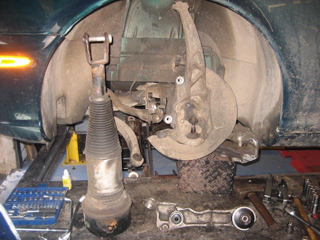

Hi Paul,
I replaced a front air strut a few weeks ago, admittedly I used my 4 poster lift which made it a lot easier but I don't see why you can't do what you suggest. My question would be how you're going to jack it up and then support it. Would that be under the sill? The key is to get enough ground clearance so that you can get the existing air stut removed and to do that you want to remove just as much as possible that's in front of you, so the brake disc, the calliper and every connection to the hub carrier - ARB, track rod end, upper wishbone etc. Be careful with the level sensor when you remove it and try not to touch the inner bolt of the lower arm as this will put out your camber setting. I’m happy to have a quick chat about it if that would help. My number used to be in the magazine – try an old copy – or PM me for a number. Cheers, Roger

Thanks Roger. Having read some more, such as Mike's long write-up, and the sheet from Bilstein that comes with the air strut, I've decided the best thing to do is see if I can get my XJS back together and off my lift. This is my chickens coming home to roost - I should have fixed the XJS ages ago!
I'd considered raising the car using my home-made engine support bracket (a long piece of 2" square steel tube that's good for lifting several tons) under the car at the front jacking points, and resting on a couple of trolley jacks at first, axle stands later. But it turns out to be about 18" too short, and I'm not convinced I'd get the clearance.
As for trying one side at a time, I'd missed the bit in the manual that says "disconnect the anti-roll bar" (called something else), and I doubt that's possible with one wheel in the air, the twisting force would be significant.
Out of interest, was getting the lower mounting bolt out as hard as in Mike's case? I'm not looking forward to a day with a lump hammer. The last couple of times with that were removing my front brake disks on the X308, and the lower wishbone fulcrum shafts on the XJS. The neighbours probably still hate me for all the noise (and Anglo-Saxon oaths).

Well the first time, it simply didn't come out at all. I removed the air strut and lower arm together and used a combination of angle grinder, die grinder and drill and tap. And a new bolt. Ever since then, I haven't had a problem. I think a bit of grease on reassembly and removing them from time to time does the trick. I think there's an account of it on the forum.
