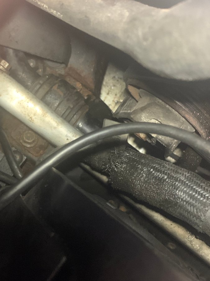

So an addendum to the above thread. The poly bushes started squeaking after a year or two and was driving me mad every time I drove over a bump. As it happened I had a pair of genuine Jaguar second hand bushes that I got with some other spares.
A few months ago when I was changing out the heater auxiliary pump, I noticed I could get access to the front ARBs through the engine bay with the expansion tank and other cooling hoses out of the way. There’s a steel u-shaped channel that runs side to side. The screws holding this can just about be removed allowing it to be moved just enough to get access to the ARB mounting screws. The other mounting screw is a little easier to access. With the screws out, the clamping bar can be removed, and the arb bushes manipulated off the bar. I think I did this from below. Then everything is put back in place.
All a bit fiddly, but squeak gone
The photos are not very good, but you should be able to just see the ARB clamps and screws. These are looking into the engine bay between the engine and the radiator.
