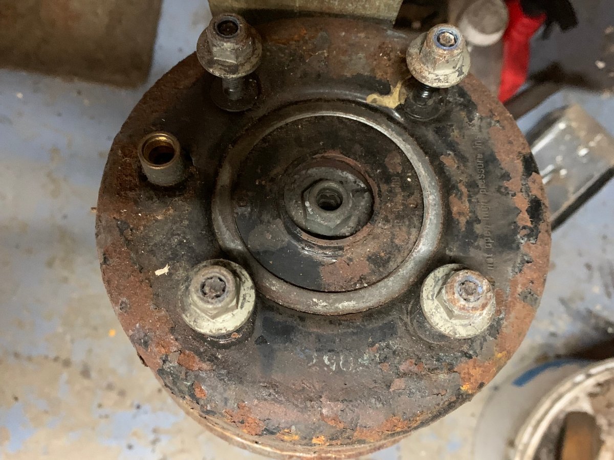

I have a spare strut in the garage - taken off as it was making a clonking noise. I could be persuaded to remove the bit you need and send it to you. Contact me if this is useful.

Sorry about this, but the one i have is off the front and now i look closely at it, it appears to be different. I cannot see a way to remove the electrical connectors.
