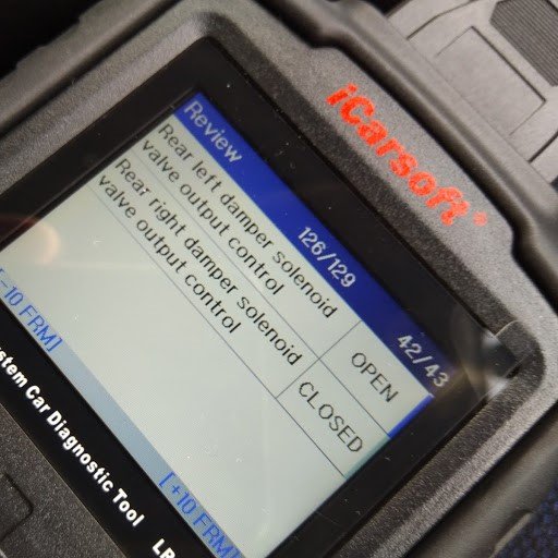

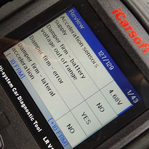

Using the record feature of the Icarsoft scan tool i've been able to get some more information on the error:
See attached 2 photos -
The data suggests that there is a rear left damper firmness Error.
For the logs leading up to the C2302 plausibility error the Rear left damper solenoid valve output control is open (all others are closed).
The ride heights of all 4 dampers at the point the error occured was normal.
I will repeat the recording tonight to ensure the same mechanism triggers the fault.
Does anyone have any suggestions as to what this could be or how to fix it?

Postby PaulGover » Thu Aug 08, 2019 12:16 pm
If one valve is open, and it says there's a) implausible levelling and b) damper firmness error, it appears that either the control is desperately trying to raise the rear left damper, without result.
I'd suspect either a failed ride height sensor giving incorrect readings, so the control box thinks the suspension isn't moving even when it is, or possibly the damper firmness error means the damper is seized or the air pipe is blocked/flattened/leaking, which of course would also mean the suspension doesn't level when it should.
