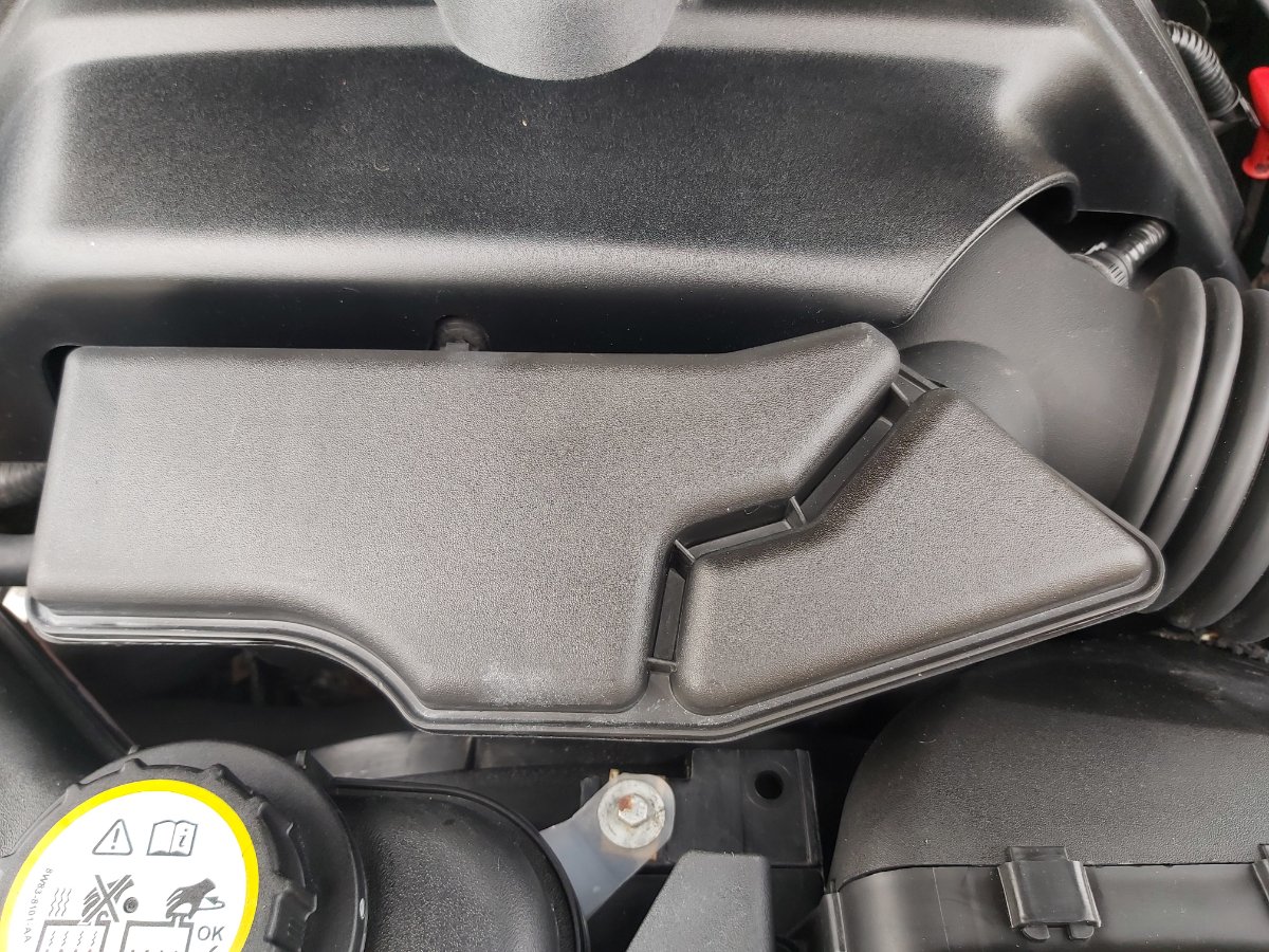

I wonder if anyone can identify this part and if possible supply a part number, please.

Hi Alan - have you tried the Jaguar Classic Parts website? https://parts.jaguarlandroverclassic.com/
You will find there a complete listing of parts for your car including diagrams

Hi Alan,
If you are referring to the strange shape lump it's a resonator to reduce intake noise at certain engine rpm. It's part of the air intake tube moulding that connects to the air cleaner box, so it's not available as a separate part. The exact part number depends on your car's VIN. Have a look at either the Jaguar Classic parts or the SNG Barratt site and work you way through the menus to get the right part for your model and year.

Brilliant, thanks for the info and the links.
