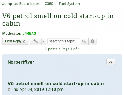

JerryL770, I'm definitely in the correct forum page. You may be confused.
There could be an indexing issue with the forum site perhaps, but it doesn't look out of order to me.

This thread is correctly positioned in the X350 section.
Indeed odd that Jerry is seeing it in the E-type section.
