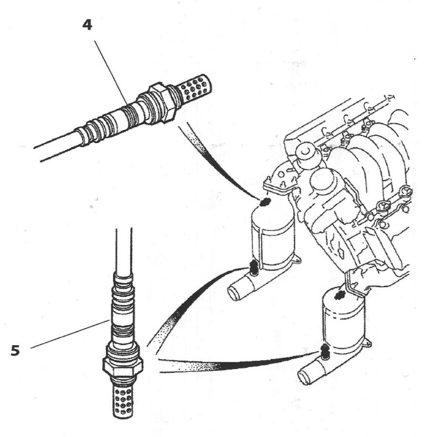

Current part price for a downstream (post cat black plug) sensor:
Either bank, all engine models, UK or north American regions:
https://www.jaguarclassicparts.com/uk/part/LNE1682BC
LNE1682BC £137.51 +VAT
Dunno what the OEM make is but some aftermarket online shops quote Denso at around £93 inc VAT +p&p (BritParts) LNE1684BB is the upstream or pre-cat (grey plug) Oxygen sensor (as supplied and changed for the hapless previous owner) is also the same number for XK8. Found at some £57 +VAT +p&p but no maker named
Update: did a gentle (max 60mph in cruise) down the A3, M25, A3 and return -- driving was shared. And achieved 30MPG. But still the P0420 EML came on the following week when just pootling around town
