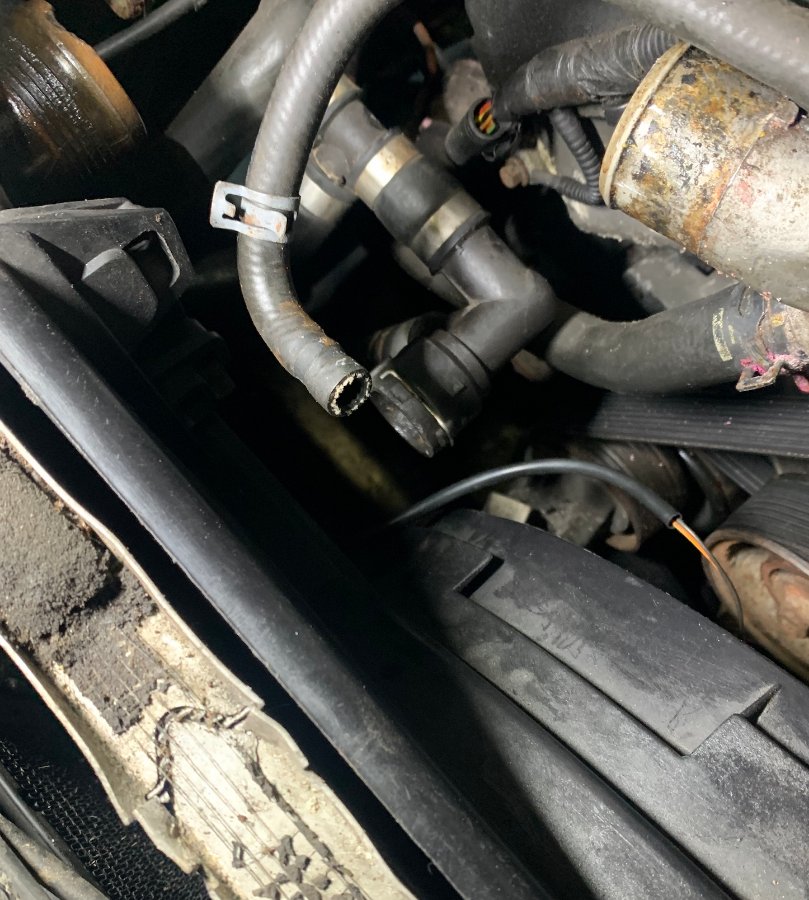

I suspect Brian is spot on, but if not, could it be the aux electric heater pump is failing after a certain time? Apparently the brushes go on them. I discovered my heating is not working the first time it got cold a few weeks ago. At the moment, my car is partially stripped under the bonnet in order to replace the pump. In my case it would appear this is indeed the problem.
Good luck
Roger
Its under the expansion tank in the gap shown in this photo.
Good luck
Roger
