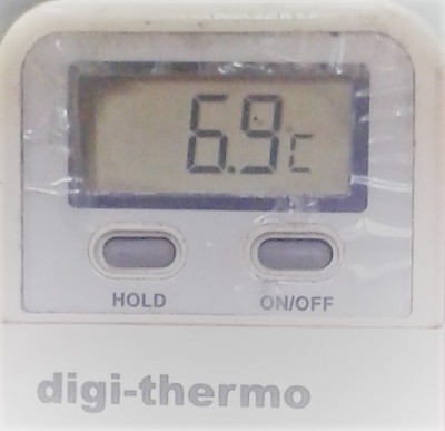

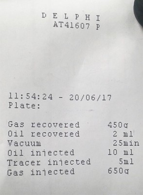

My car was around one third of refridgerant cool level short and the vent temperature could only get down to 12 degrees. On hour later, the Delphi automatic service machine had done its stuff. The correct charge weight had been re-established, pressures were correct and the air vent temperature had dropped to 6.9 degrees. The technician was well pleased and lead me through the process. £49 paid over and off I went again.

The service of the air con is worth doing for the following reason alone. That of pump lubrication. You will see from the print out that my oil level had dropped. Not that badly in my case, but if left to continue, could cause oil starvation to the pump bearings. I know we have seen one such case of this recently, I think on an X300 which caused the pump to seize solid on a motorway. Showers of sparks and clouds of rubber smoke as the engine continued to turn the drive belt against the siezed pump. Not good.
That my system was due for this service is without doubt. Given running for another year, then I could have expected to have to pay out for replacement parts plus a commissioning of the system.

What you've done Mike is more comprehensive in that the system will have been vacuumed out so removing any moisture and checking for leaks by checking that the system holds the vacuum for a set period of time. The better ones also pressure test as a system can hold vacuum because it pulls in the seals but may not hold pressure when the gas pushes against the seal.
