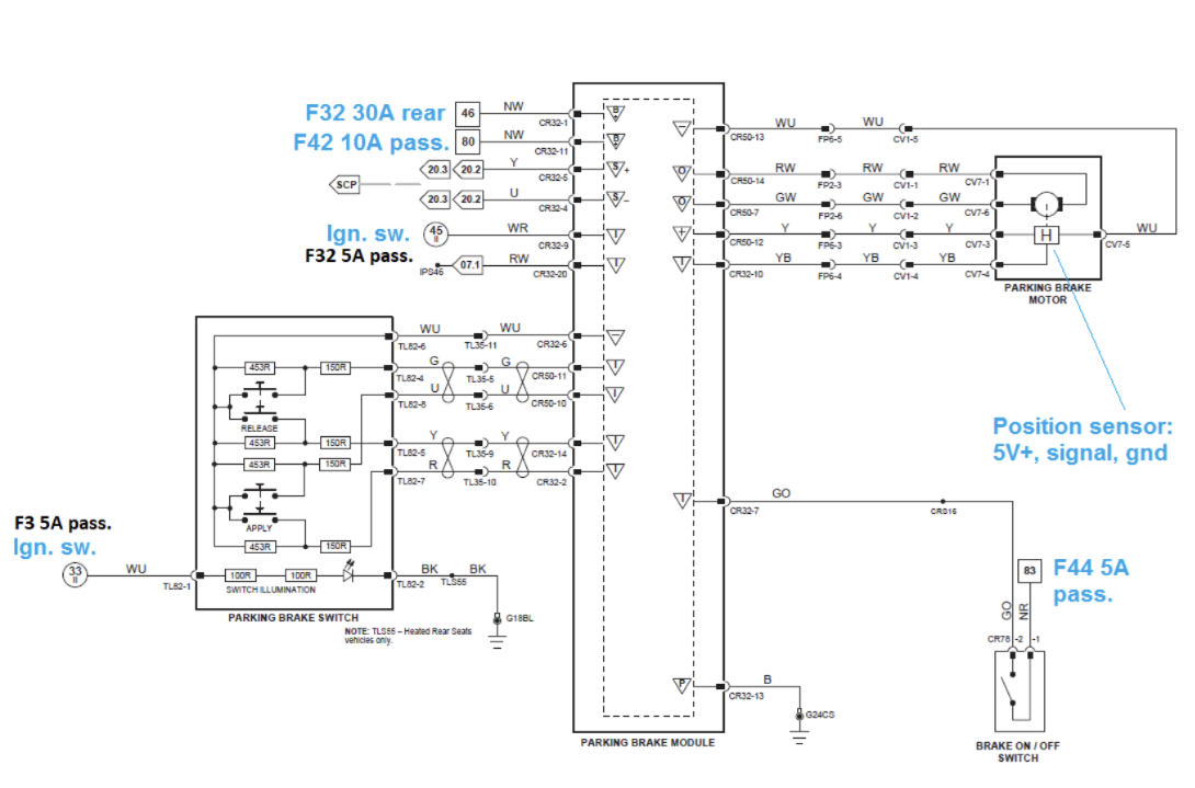

I managed to find the diagram from that old post.
Agree on motor conductors being Ok. I guess that leaves the hall effect switch conductors to check.

That's great thanks for the diagram should help to track the problem down.
Thanks for your time and trouble

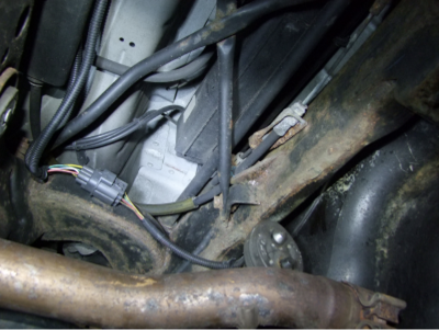

Whilst trying to trace fault I found this info bulletin XJ206-07
On the EPB actuator side of connector CV7(under the vehicle) check resistance
between the following points:
• Pin CV7-1 and ground (pass value: open circuit = resistance above 10 megaohm).
• Pin CV7-6 and ground (pass value: open circuit = resistance above 10 megaohm).
Can anyone tell me the position this CV7 connection is description saying it's under the vehicle?
Not having access to a lift some idea of where to look would be a big help as some wires from the brake switch and the module have a LOW READING TO EARTH

Re: Park brake fault
I'm pretty sure its the one connecting the motor to the sub frame harness. Its not easy to get at. Its high in the subframe towards the back on the passenger side.
I think this is what you are looking for.
Note: this is not my car. I think the diff has been removed here.
Thank you much appreciated, that's got to be a big help in locating the connection.
