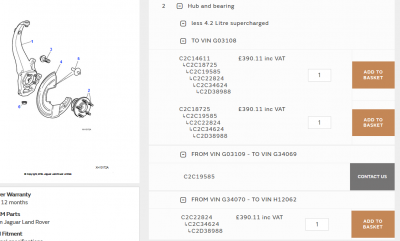

Looking for replacement wheel bearing assembly for my X350 VIN ending G31406
On the Jag site, earlier and later VIN shows C2C22824 being suitable:
... yet G03109 - G34069 shows I need C2C19585, however that's a discontinued part. However, when clicking into C2C19585 it shows:
... which says C2C22824 supercedes C2C19585
I'm confused. Is there something about G03109 - G34069 which is different... or could this simply be an error? Can I use C2C22824?
Any assistance appreciated,
Jeremy
Confused over part number
Re: Confused over part number
Jeremy,
My reading of that is that JCP have just missed off the supersession information for the middle range.
It seems that all the previous part numbers including C2C22824 have ultimately been superseded to C2D38988. So, that's what I would fit.
Alternatively just drop an email or give Glen Parkes a call at JCP and explain the issue.
Good luck

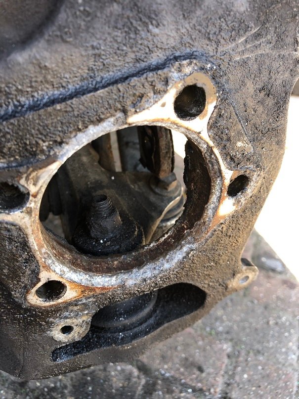

Mike, wondering whether you have seen this approach?
https://www.youtube.com/watch?v=x8Vamjqy7_Q
... guessing you would you advise against it, but curious why... it looks fairly quick compared to dismantling as you describe, but life has taught me to look for the catch
Thanks,
Jeremy
The extracted bearing cartridge in the video has obviously been well flooded with WD or similar product. I`d not seen that particular method I must admit and if I were to try it, I would be using four nuts and bolts to spread the load. It would be all too easy to damage the relatively soft ali leg using just a two bolt method. I noted only a very small amount of corrosion between the two parts on this video example. Usually, it is much, much worse!
All cases are different. I`ve seen one un-bolted bearing cartridge just drop out onto the floor after just being given a good clout with a block hammer. All the ones I`ve tackled have not succumbed to that treatment and needed transferring to a bench press for the five ton loading. Shame!
Obviously the method shown is not "approved" as such. I certainly couldn`t endorse it but its obviously up to you if you want to give it a go. I`d stay stop immediately if you think loads being applied to just a couple of points are getting excessive. Go easy if you do what is shown in the video and think constantly about safety and loading aspects. Flying metal is airborne shrapnel. When these cartridges finally start to move, they can go with a hell of a bang.
Hi Mike,
Happy to report that the leverage method worked - angle grinder to cut enough off the wheel studs to knock them through, gradual application of force at 3 points around the hub, it came out within a minute. Took me far longer to loosen the bolts in the first place.
Anyway, thought I should follow up and let you know it had worked - and thank you for your cautions.
