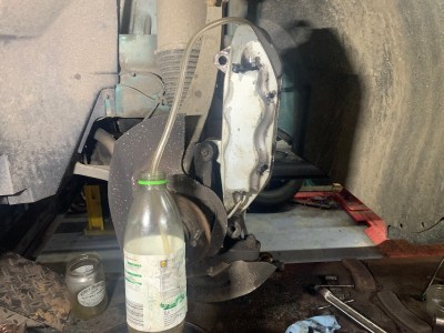

The Brembo calipers have 4 pistons, the two at the top are slightly larger and one of these was sticking. I managed to get all the pistons out and used a rebuild kit to replace the seals and fit new pistons. I thought it would be an easy job to refit and bleed through using my usual method of using an Eazibleed kit, but I just couldn’t get all the air out and at this point you started wondering if the master cylinder has failed in sympathy. I checked a few forums and did find some interesting advice to tilt the caliper so the bleed nipple is uppermost- see picture – but this still didn’t help. One thing that I never realised - and I’ve owned the car a few years - is that these calipers (front and back) all have 2 bleed nipples. One is obvious to see, but the other one tends to be out of sight. This made no difference though.

Undo bolt and tilt caliper so nipple is upmost
