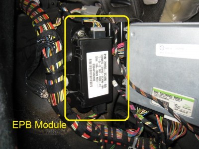

Is there anywhere online where I can find images of what the control module looks like and where it's located??

From memory, David, you should find it OSR behind the side carpet adjacent to the grey rear electronic module box. It appears to be the black plastic boxed unit which is shown in the attached image.

As you'd expect, the box isn't where the picture suggests!! Before I start pulling carpet elsewhere, do you have any ideas where it could be otherwise located!!??
