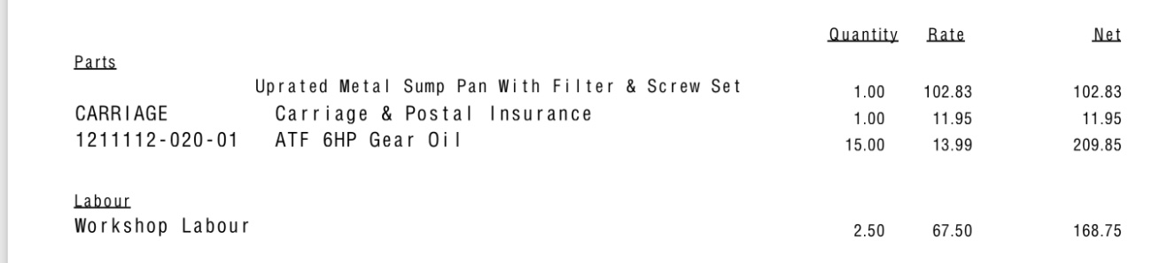

So i received a quote, not cheap (all +vat) but something i’m still planning on undertaking:

I eventually had this done earlier this week at Autotech Independent BMW specialist in Langley near Slough.
It cost £630, which included 12 litres of ZF Lifeguard 6 fluid, genuine ZF pan/fiter, bolts and 3 hours of labour. They use a machine to flush the old fluid and fill until they see clear/new fluid. Remember a drain and refill only replaces 7 litres of fluid and doesn't touch the fluid in the torque converter.
Downshifts are much smoother now when approaching roundabouts, junctions etc. It does also appear to be accelerating quicker too; regardless, upshifts are now imperceptible.
Not cheap, but potentially could be done cheaper as Autotech allow you to supply your own parts. There is an equivalent fluid sold by Smith and Allan which one advocate believes is the same fluid supplied to ZF by Shell. A Febi-Bilstein alternative is also available - both of which would knock150-200 of the final bill.
