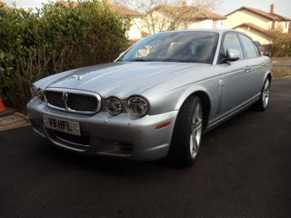

While I'm here......my car doesn't have front fog lights yet some do, are they a different model/variant?

Re: Jerky Gear Changes
That would seem to be the case on later 358 models as seen in this image.
I shouldn`t worry about it, David. I have fog lamps on my early model and they are pretty useless.
