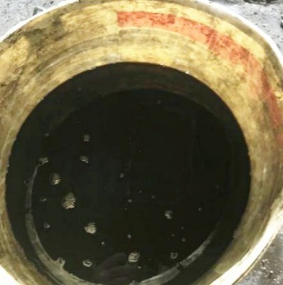

Well My X358 is now 10 and a bit years old been mine for the last 9. I have thought about getting the gearbox oil changed over the last couple of years and have now had it done with ZF oil and kit , the good news was that there were no debris on the magnets and the old fluid was ok.
Now has 126,000 on the clock and over 100k of that has been our use. Avg fuel for the last 1700 miles is 42 mpg according to the trip.
Work was carried out by Chris the Jag specialist at Doncaster who has all required jaguar software . Changes have always been smooth and quiet but it does seem quieter and more smooth now. Just hope that she will run for another 10 years and continue to be as good as the last 9!

My 358 was done 18 months ago, but 12k miles in it was almost un-driveable again, cattle gridding, harsh changes when it wanted, I was looking for a new box, undaunted I bought another kit from Bristol Transmissions, took it to a local JEC member who runs a garage with the right kit to do the change and flush, DM conversions in Dunbar. Job done, another 20K miles in and its as smooth as silk, 203K covered now

Just had mine done by a local indy, using the kit from Berkshire Jag. I didn't believe the hype over getting the box oil changed, until I had it done on my 121k mile V6. Transformed the way the gearbox changes and moves from drive to neutral, etc. No more jumping into drive and no hesitation between the gears. Highly recommended procedure. Old oil was black, but not glue thick.
