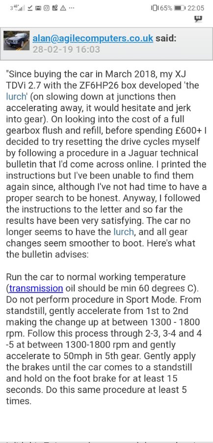

I did find a tech bulliten and aon the jaguar forums about a relearn process. So I tried that this morning. Will have to wait till tomorrowmorning to see if it made any difference. Though I don't think it will
I have read a lot on various boards about a hard reset... disconnected positive and negative and then short positive to ground....my back ground is electronic engineer so I understand the logic of discharging residual current and not doing any damage...but I don't know the one and outs of the electronics of this car and feel a little aprihensive. But I may go there yet....
On my last two Mercs there was a way of resetting the gearbox via hidden menus on the car itself. But Jag don't seem to have that option. I'll move slowly and cautiously on this one as I dont want to f up the box.... I have attached an image of the thread I found for information. I also did find 2 or 3 versions of a tech bullitens which pretty much say the same thing

....so far I have carri d out the reset method mentioned on previous post....my biggest problem there was that I could not get the car to go into 5th gear below 2000 rpm no matter what I tried. So I am not certain if it worked correctly. Also not certain if it made any difference.
On Thursday morning I called into my mechanic and he was able to reset the gearbox adaptations. So from what I understand it is relearning at the mo. Bit not sure if that is correct. Also so far it has made no difference.
