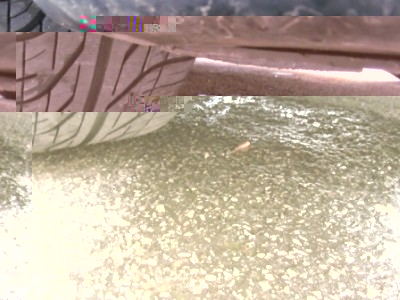

here are some pics outside XJK the day after the car arrived with them and two days after the failure, and still dropping oil everywhere, apparently the workshop clean up did not go down well!!
