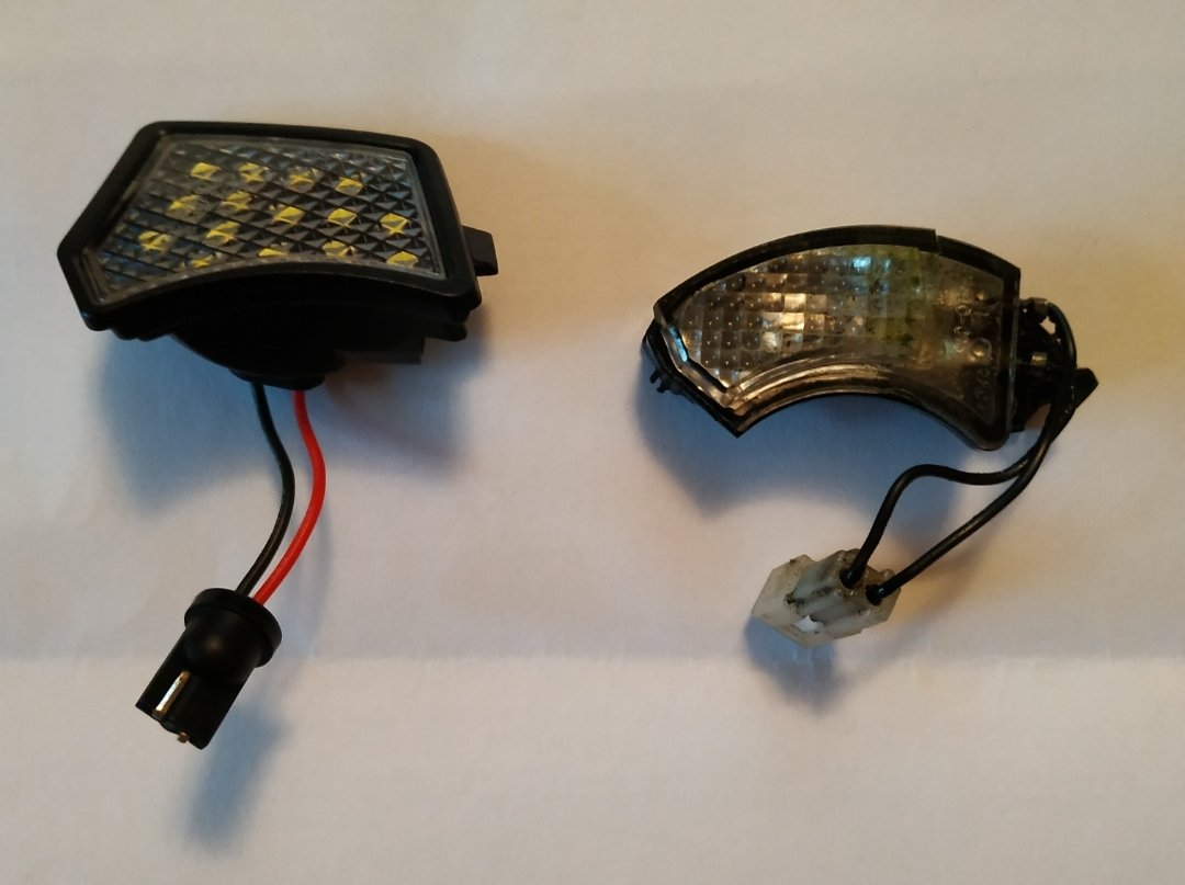

Wiggling side to side worked to free the puddle lamp housing. The bulb is dead, so I might take the opportunity to swap out both sides with LED versions. I think a pair is only £20.

Unfortunately the replacement led puddle lights are not the same type as the ones on my 2004 X350.
I'll have to return these, but I'm not sure if it's possible to get direct led replacements for this style. Richard

Postby Norbertflyer » Thu Sep 22, 2022 9:30 pm
PS - managed to get the old NS puddle light working after swapping out one of the thin leads which had presumably broken, with some delicate soldering. So, it wasn't the bulb which I believed had broken.....
I can't find any LED replacements for the type of puddle lights on my motor.
