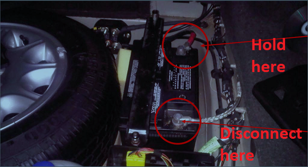

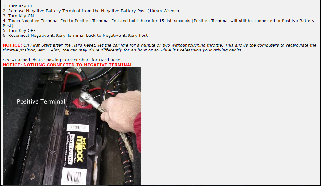

Hi Ken.
First thing I would try would be a hard reset.(Make sure you have your radio code)
Disconnect the earth terminal of the battery and hold it onto the positive one for 20-30 seconds.
Then reconnect the earth terminal and see if anything has changed.
Full instructions are in the second photo. If I get any electrical issues this is the first thing I try.
Hope that helps and let us know how you get on.
Good luck and take care.
