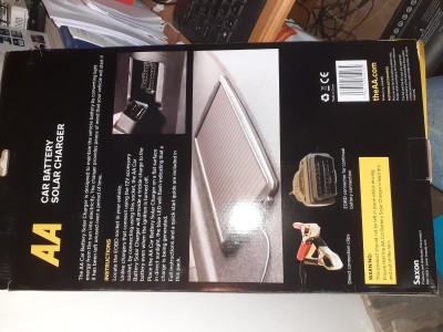

I have an AA solar battery charger that does the same thing. I always use it if I'm not using my XJR X350 for longer than a couple of days.
