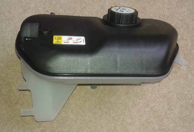

So here is a new C2C41300 tank before fitting. This part number appears suitable for the supercharged XJR manufactured between 2004-2009.
This part is only available via the Jaguar parts supply chain and in this case this tank only fits supercharged models. The normal ex-Jaguar price is around £105, less any discount you can obtain by showing your JEC membership card. Always do a parts search before commiting to buy from any particular dealer. My tank came from Taunton Jaguar via ebay for £72 delivered....so I was obviously very pleased. One might assume dealers perhaps order parts for their own use or that of a customer. Some may not collect an item, which then gathers dust on the stores shelves. If the dealer stores man has some savvy, he then attempts to knock the unwanted part on on ebay or a similar internet site in an attempt to claw back some money. My little win came just as a result of typing C2C41300 into Google. Five minutes later, the tank was ordered and paid for. Job done...... everybody very happy.
This is a general view of the tank. The stub pipe from the intercooler circuit is at the nine o`clock position and is the part of my old tank that has been causing the leakage. This is the intercooler flow pipe detail. The very abrupt change of cross sectional area ie tank/pipe does not help long term tank longevity and these tanks and even those on NA models right across the Jaguar product range, are well known for breakage or disintigration of these pipes. So go very easy if you have to take one of your pipes off your header tank whatever Jaguar model you run. The pipes can become incredibly brittle given age, heat and high mileage. Ideally, having fitted this new tank, I`d rather like to see if I can cut off the leaky pipe and drill and tap a thread into the old poly prop tank at that point. The remaining 99.9% of the old tank is in great order. It is sad that the old tank is in generally in such fine condition and unless a repair can be effected, it looks as if it will be scrapped. It strikes me a small threaded brass hose nozzle could be screwed into the tank and a repair effected. Thats a job for a few idle moments.

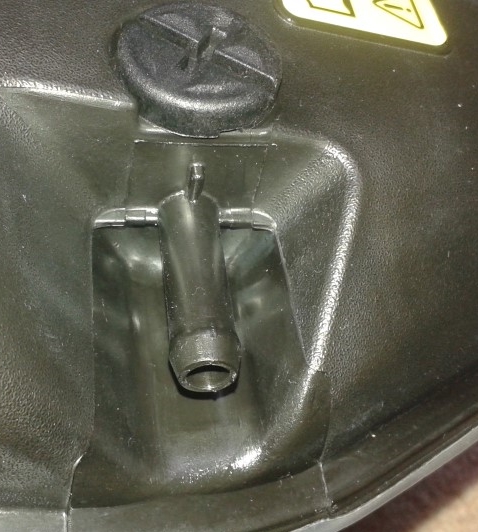

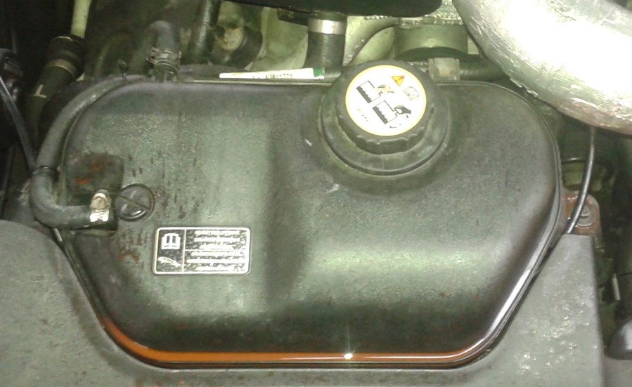

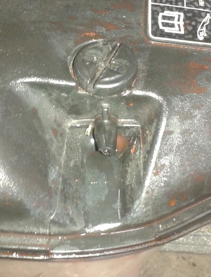

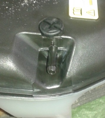

New tank fitted this morning....not before another bit of stub pipe fell off. This old tank was living on borrowed time. Best advice then must be to get a new tank before your old one disintegrates.
Here is the detail of the disintegrating header tank stub pipe. In this case it is the return from the engine coolant circuit.
Here is the detail of the new header tank stub pipe. In rather better condition I think you will agree.
