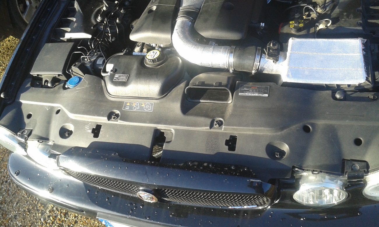

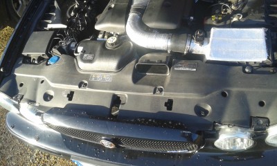

I began by removing the air inlet pipe from the air flow meter tube to the intake plenum. Two large jubilee clips are removed to allow the pipe to be taken from the car. Remove the part load breather pipe from the induction pipe. The entire air cleaner box should be removed for ease of access which is held in place by just one long 8mm bolt. Two screws hold the air snorkel to the front slam panel. The snorkel is easily removed from the air box to facilitate easier removal.

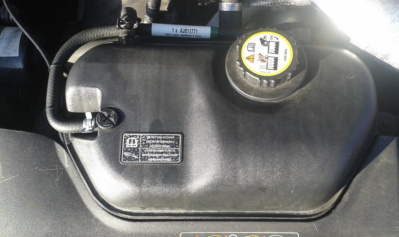

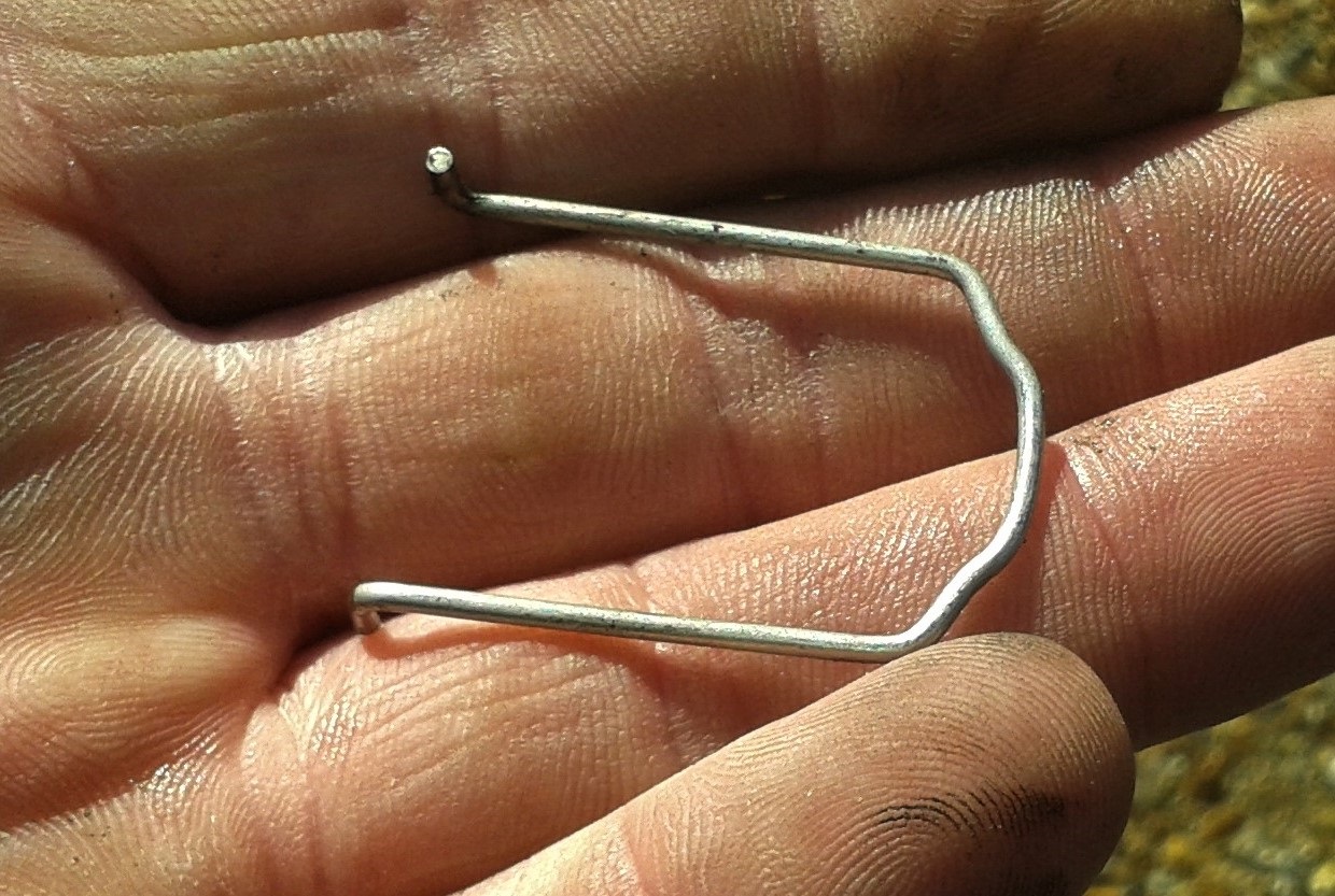

Removing the header tank cap allowed me to pump out the tank and save the coolant for re-use. Remove the long bolt securing the tank to the slam panel. Slide the tank to the right disengaging the tank lugs on the left side from the body mount. Lift the tank and remove the low level warning sensor plug from its socket on the sensor. Locate the spring clip holding a hose to the lower portion of the tank. USE LONG NOSE PLIERS TO PULL THE CLIP TO THE RIGHT. Get your hand on the clip and fully extract. Guard this clip with your life and do not drop or loose! A lost clip might mean having to buy a complete new tank. Pull out the hose from the header tank. Expect to drop some coolant when separating the hose from the tank. Remove the two small hoses at the top of the tank. Go easy with this operation. The stub pipes on these tanks embrittle with age and heat. They snap off easily. If that happens, a new tank is the only option. Supercharged and non supercharged models use different tanks. If needing a new tank, ensure you get the right one. The supercharged tank is more expensive as it has an extra chamber built in for the supercharger coolant circuit.The replacement tank is about £100. Use only the OE product, not a Chinese copy. Remove the tank from the car.

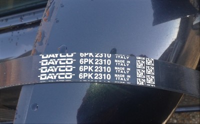

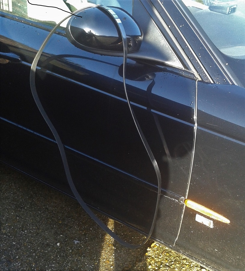

The prime belt is quite a length as seen in this image. Fitting it can be quite a challenge. I`ve used Dayco belts for many years now without issue. The cost for this serpentine belt was £20.50 delivered via ebay. A Jaguar OE belt I saw was listed at about £95! Make your own choice. The supercharger belt I fitted sixteen months ago is also a Dayco product and came for a similar price.
Perhaps make a note of the Dayco part numbers for future use.
Dayco after-market 6PK-2310 is the main drive belt for water pump, alternator, PAS and air con.
