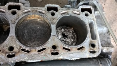

Seen on ebay, a 4 litre V8 XJR engine suitable for spares or repairs.
The engine popped a coolant pipe, overheated, dropped a valve seat and knocked a hole in a piston crown! Un-seen and un-loved, the valley pipe gives up after high mileage and advanced years. The cost of the pipe is about £25. The difficulties of charger removal are horrific due to tight working space. However that pipe must be inspected to ensure it does not expand, split, rot and and eventually blow right open which can lead to a written off engine. Have you replaced your valley pipe recently? Here is the reason why you should!

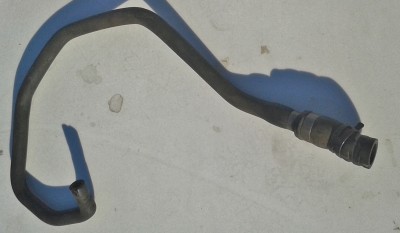

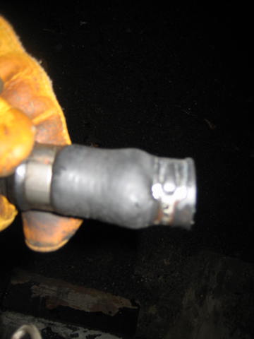

Although the above image is of the 4 litre XJR engine, the issue also affects the 4.2 installed in S-type R, XKR, XJR and early 4.2 XFR models. The replacement pipe part number is 2W93-9F814-BC. (Late edit correction to part number) Note the bulged portion of the pipe in this image. The damage is a couple of inches back from the fat end of the pipe. The material structure decays, the pipe becomes soft and eventually balloons before splitting wide open! Whooosh!!!!!

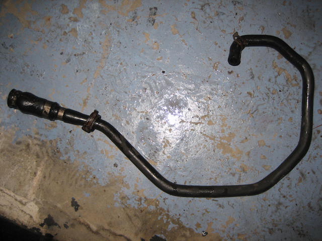

Here is a good clear image of the valley pipe which has been replaced. The damage forms at the right hand side of the pipe in this shot. Picture courtesy of Lawson Smith at Powerhouse Engineering. Ignore the red and blue pipes...that is part of a nitrous oxide installation!

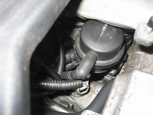

I've just taken a look at my car and taken this photo.
Viewing from the driver's wing side, you can just see the two pipes going to the throttle body - looking very new in my case. Right at the bottom of the shot is the other pipe I mentioned. Its really not very easy to see any of this without a lot of stuff being removed.
Here's a photo of the full valley pipe.
The point of failure is the 1" or so of larger diameter pipe right at the end. You might just see the pin prick hole.
