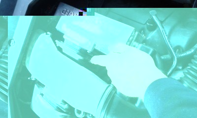

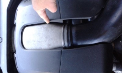

To find this pressure pipe follow the photo sequence here.

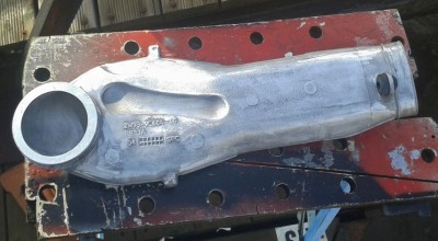

Disconnect the inlet pipe from the top inlet plenum. A Jubilee clip secures the plenum to the throttle body throat. It is not that easy to access and you will need a spring drive 8mm hex socket to slacken off the clip. Left the plenum up from the throttle body and slide towards the front of the engine. A horizontal dowel which locates at the front of the plenum, holds the front end of the plenum to the car. WD 40 will help a rubber grommet on the plenum slide along the dowel. The supercharger plenum outlet plenum or "cowhorn manifold" is then exposed. A metal stub pipe is on the near side. An old rubber pipe will often drop off that pipe. replace the rubber pipe or secure as required. This shot shows the plenum inverted and details the circular part of the plenum which engages the throttle body plenum to the left with the grommet lug to the left.

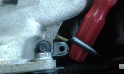

This is the "cow horn" manifold. with the sub pipe just over the top and downwards around the two o`clock position in this image.
Here is the pesky swollen ended old rubber pipe and the "cowhorn" stub pipe. The two items need fixing back together again to cure the air leak and persistent fault codes.
