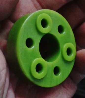

Applicable to all V8R or straight six earlier (X300) model Jaguars, Lawson Smith at Powerhouse Automotive is able to supply an up-rated drive shock coupling for cars equipped with Eaton M90 or M112 superchargers.
This coupling is a beefed up replacement for the OE unit which can be somewhat short lifed. Age and mileage can take its toll. Failure of the coupling can be easily heard as a pronounced knocking from the rear end of the input snout housing. This replacement has an elastic type core to absorb drive shocks and loading. The drive cushion material is totally encased in a green nylon plastic outer case which I assume helps to contain the inner part and prevent break up. Reasonably priced at around £25 plus VAT and small postage charge. Phone Lawson to discuss your precise needs. A great chap he is too. The web site is also well worth a look.
Powerhouse specialize in the supply of JLR/Eaton supercharger parts and also offer charger re-porting, modification of drive snouts to accept super small pulleys, as well as being able to rebuild superchargers to an owners specification. Help and advice is freely given.

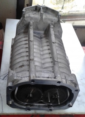

Due to my own physical problems and the above issues, I was eventually obliged to send the car to an independent Jaguar maintenance facility to complete for me. The charger was returned to me so that I could replace the coupling and change the oil together with carrying out major porting and polishing of the charger, case and upper cowhorn pressure manifold. That was the easy bit!

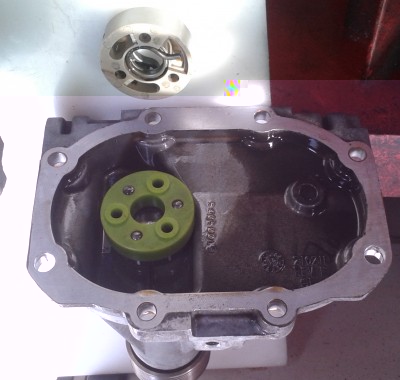

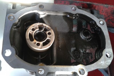

With the charger on the bench and having drained the oil, eight E10 bolts are removed at the front of the charger case. The extension drive shaft snout can be pulled away from the charger case which reveals the push fit coupling as seen here. Drive peg holes in the coupling were all slightly ovaled and worn. Removal of the old coupling and replacement with a new item is simple. Rebuild is the reverse of disassembly with new oil being added to complete the job. I was warned that the uprated coupling would be a little noisier than an original part. From start up after rebuild, this is certainly the case. At idle there would appear to be an increase in gear noise probably due to gear backlash. With the bonnet closed down, the noise is much reduced although still audible. Once in the cabin, then any extra noise at any speed is undetectable. Whether I would fit an uprated part again on the charger, is debatable. However I am running this car at much higher power levels than a standard car and am happier with the stronger part being in that drive train for this car.
