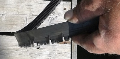

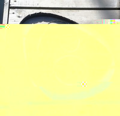

Here is one I successfully shreaded earlier....when it fell off the smooth idler pulley! Ribbed and eared up-stand replacement idler pulley stopped that and reduced noise....with a new belt!!

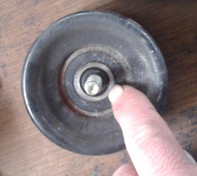

Check also for wobbly pulley bearings. having removed a belt, go to the idler pulleys and check for them falling around. Unscrew the central (usually 13mm bolt) and screw out the bolt from the mounting. The central ball race often locates in two thick washer type parts, each with an 8mm thread. each washer can be wound up and down the thread to set the support length fr the pulley bearing which controls its wobbling around. a washer at either end relative to the ends of the bearing, will support the pulley and there will be no wobble. if the two washers are towards the middle of the bearing, the pulley will be unsupported and wobble when under belt load. that does make a noise. In this shot, the finger points at the pulley bearing with the "washer with the thread" around the 8mmmounting bolt. Washer movement is rare, but it does happen. Mike
